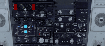

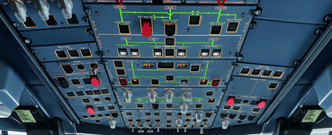

The traditional Guarded electrical switches changed form about 30 years ago. but they still have RED guards over them, and are usually safety wired with 0.020" copper breakaway wire to discourage accidental deployment of the switches.
The Traditional Toggle switches as seen on a DC9's overhead panel, these are raised plastic guards that cover the old style toggle switch's, compared to the flat RED guards over the push button switch's on a A320's overhead Panel.
And while I have never been in the cockpit of a 787, I assume they are similar to the cockpits of 757, 767, & 747-400's that I used to be taxi qualified on. And yes the fuel control cut off switches had to be pulled up to change the position of the switches. So I agree that inadvertently "bumping" the switches would not be enough to change the switches position.
