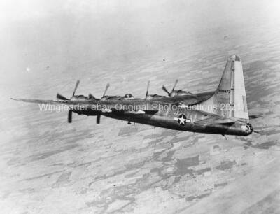

eBay: Consolidated B-32 Dominator (2 Viewers)
42-108472 was first B-32 delivered (Sep 19, 1944). W/o the very same day when nosewheel collapsed on landing.
