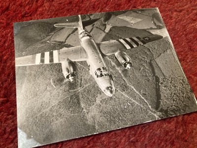

42-107683 B-26C-45-MO ( Martin Co., The Glenn L. Omaha, Nebr. )
Seller Around D-Day, cristal clear photo showing a B-26 of the 344BG with nose art " Lil Audrey " Serial 42-107683. Fuselage code 7I identifies 497th Bomb Squadron
