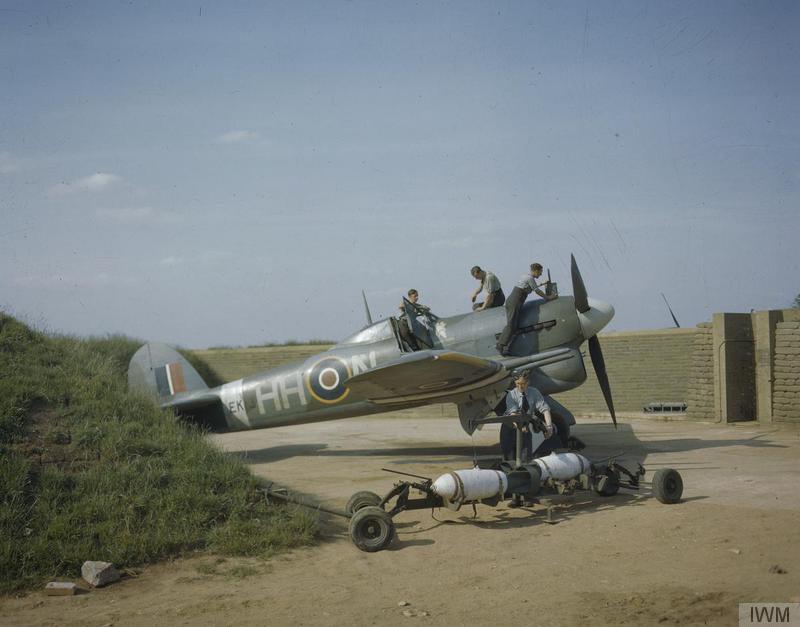

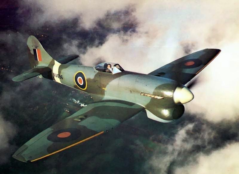

I'm sorry if this sounds dumb but can some of you people please tell me more about the typhoon and tempest i dont know much about them
The Typhoon (Sabre engine) and Tornado (Vulture engine) were scheduled to be the RAF front line fighter into the 1940s. However Tornado with the vulture engine was cancelled due to Rolls Royce having no time to develop it after war was declared. The Typhoon fuselage had problems, the wings were too thick which caused problems, the engine was unreliable. It was rushed into service to cope with the Fw 190 tip and run raids, it did that but developed a bad reputation because it wasnt sorted.
Since the Spitfire was developed further as a fighter the Typhoon became a beast of a fighter bomber.
To solve the above problems the Typhoon got a new fuselage, new wings eventually a new (centaurus) engine and a new cockpit which became the Tempest one of the best performers as a fighter at low level during WW2. The next in the line was the post war sea fury very similar to the Bearcat in almost everything.
