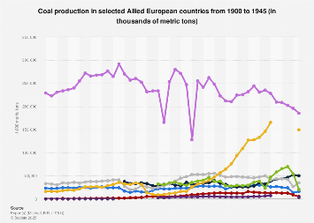

Do you have similar data for the coal types that Germany could've also used back in ww2, coming from France, Belgium, Bohemia, Poland or Ukraine?
Here are the analyses for Polish and French coal:
Coal production of the Axis powers and the occupied countries is given in the following table (thousands of metric tons):
Data is from the following website.
Polish coal is estimated
Clearly German coal production dwarfs the contributions of the other countries
