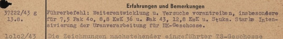

There was an idea from 1943 that uranium might've been useful for the cores of the APCR ammo. I'm not sure that anything was actually done about it.
('Stuka' here means 'sturmkanone', ie. a cannons on the Stugs and the like)
Unlike tungsten, uranium - it's ore - was something that could be mined in Germany and Czechoslovakia.
I suppose the problem with that is that there was very little demand for uranium before the advent of nuclear weapons and power. How quickly can you scale up mining and processing of a new material? 1943 at least is too late for Germany?

Seems like another idea that came too late, indeed. Uranium ore was contained in the ores mined already in 19th century in Germany and Czechia, and indeed uranium was a known and unwanted product (link). If there is approval for the idea already in September of 1943, arriving at useful quantities might've happen, with the early testing in the mean time with whatever uranium can be scrounged from the German civilian institutions? Possible initail manufacture and use by the time of D-day?
Too many uncertainties, even with Germans not bothering to make the depleted uranium.
Seems like the uranium from Congo was up for grabs by 1937; granted, by 1943, it might as well be on the moon as far as the Germans are concerned, not just because the Americans swiped it up :)
Hmm, without an enrichment program for weapons or power, there's no depleted uranium either. If you want uranium just for AP, it makes no difference whether it's natural or depleted. DU is used because it's a cheap byproduct of enrichment, not because it has any particularly desirable property that natural uranium lacks.
Metallic Uranium (ie where the fissionable isotopes have not been refined out) and DU have the same basic density and the same mechanical properties when alloyed with other metals. The only real difference is in the higher amount (~40%) of dangerous radiation emitted by the non-depleted Uranium metal. But even the higher amount of radiation is somewhat negligible due to the very small percentage (0.73%, ie less than 1%) of fissionable isotopes found in uranium ores (including pitchblende, which was available and was the source of German Uranium in WWII). The German Uranium ores available were primarily in the Ore Mountains region, south of Chemnitz and Gera.
Post-war, under the Soviets, over 220,000 tons of Uranium ore were mined from this area.
