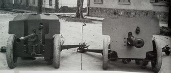

About weight considerations, there is the case of the French 25mm.
The original Hotchkiss SA34 weighed 480 kg and was initially suitable only for low speed (horse) traction - up to 15 kph -, later improved to medium speed traction -35 kph - around the 2000th gun made.
The APX SA-L 37 had a much lighter carriage reducing total weight to 310 kg, but was more fragile so limited to 15 kph traction like the early SA34, with the reduced weight nonetheless helping the horses and gun crew a lot.
The Levallois factory's (nationalized Hotchkiss) SA 34 Modifié 1939 which was adopted in early 1939 and just coming in production in June 1940 was lightened (lighter steels, lighter and simpler shield, muzzle brake to cope with the recoil even at reduced weight while also reducing recoil length from 240 to 200mm), but also made suitable for high speed traction: 70 kph in manuals and up to 85 kph in testing. 370 kg, so 60 heavier than the slow-traction SA-L 37 but 110kg lighter than the slow/medium-speed traction SA34.
For comparison, the 37mm PaK 36 with similar armor piercing capability weighed 450kg (327 in combat).

A gun like this would've been good for plinking the German tanks in 1939-40. Usage by anyone past 1940 will be a dubious move, especially for the Germans. The 28/22, for all it's shortcomings, was offering more than 50% better penetration.
On a flip side, this gun shows just how light the full-power 25-30mm guns (like the French 25 ATG, or the single-shot MK 101/103, or the 1-shot French AA gun) might've been when tailored if tailored towards the lightness, with or without the semi-auto feed system.
