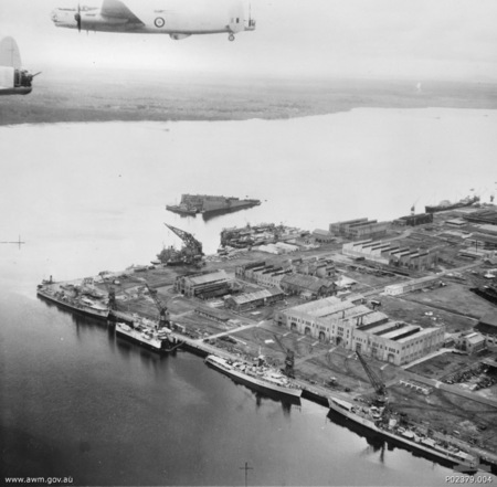

The change in attitude is best shown by the decision to build a new naval base at Singapore, which was announced in 1923. Construction started slowly and gained a fresh impetus in 1931 following Japanese moves into China. It opened in 1938 but was still under development on the outbreak of war with Japan in Dec 1941. Imperial defence was then based around sending a large fleet east from Home & Med waters to Singapore and advance via an advance base through the South China Sea to relieve Hong Kong and defeat the Japanese fleet.
