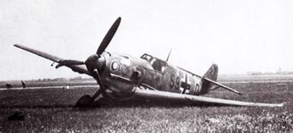

Attached below:
  1. Bf 109 E-7 S9+LS – belly landing, likely near Kuteinikovo, Rostov region
  2. Bf 109 E-7/B S9+BS – Belgorod, June 1942
  3. Bf 109 E-7/U1 S9+KS – Belgorod Oblast, July 1942
This could indicate that S9+LS (W.Nr. 4212) was lost near Kuteinikovo before 8./ZG 1 transferred to Italy later that summer.
