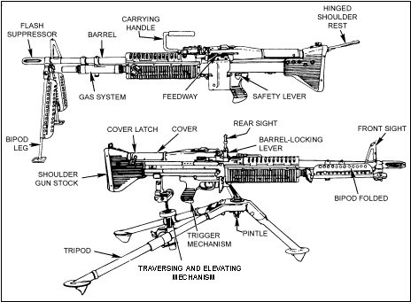

I call BS. Unless you were letting it rest for an hour after each two or three belts. The notion of a machine gun that never jams, or that you can shoot 1,500 rounds without a barrel change is 100% nonsense. It's just basic physics - shooting a .30 caliber bullet generates a lot of heat. There is no air cooled machine gun currently in existence (let alone in WW2) that can dissipate it fast enough to prevent overheating and the warping and melting of metals, which inevitably causes a stoppage.
Here is an M60 shooting 1,500 rounds. Notice the barrel is glowing red hot after one minute, and it's actually on fire after two minutes and 30 seconds and starts cooking off rounds.

The British figured the 7.92mm Besa was good for about 800yds range. The Besa was also rather noted for it's accuracy. The Germans generally figured that the 7.92mm machine guns in
Their tanks was good for 1200 meters or sometimes a bit more. Why the Difference? Also note that tripod mounted machine guns were often good for around 1800 to 2500 yds or more.
Are we to assume that a 40-60lb tripod is more stable than 20-30 ton tank? Different sights? Gun captain uses binoculars to spot the fall of shot?
One reason is that you can lock the machine guns down on the tripod and use a mechanical device to elevate and not you shoulder muscles. You can also use a sight that adjusts for distance. Even the M-60 had one of those. ;)
M3s had an elevation wheel to control the gun, when the gunner let of the elevation wheel the gun stayed elevated at the same angle it was set at, if the tank was not moving.
If the 2pdr gunner took a deep breath the gun went up and down, there was no elevation wheel,

So compared to an M-60 the British tank gunners had a sight that was fixed in elevation and
When firing off the tripod you had a mechanism that would allow you traverse but you had to adjust the elevation with your shoulder. Unlike what the M-60 really had. While guessing how high you had to hold over because your little slider on the back sight was frozen in position.
Stupid but that is what the British gunners were dealing with and by extension the British tank commanders.
that curve piece right in front of the gunners shoulder is how the gunner actually aimed the gun. the curve went into shoulder and by moving the shoulder up and down he controlled the actual elevation. there was travel which held the gun from bouncing up and down while traveling.
