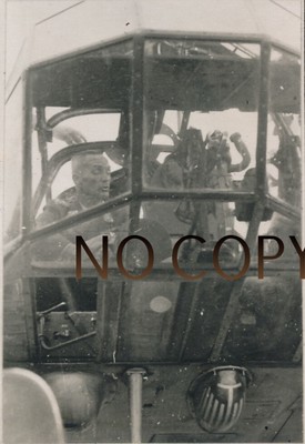

unknown puzzle again
I believe they where some kind of metal strips adhered to the plexi-dome, and not painted on markings. Some kind of direction finder or some such kit. IIRC
You are right: this is the Peilgerät-antenna PeilG 4. The middle part is rotating in the same manner as the big loop-antenna on some a/c. The photo below is a PeilG used on Bf 109E night fighter as well, and is the same as on the Fw-189 photo:
As per the German description the stripes are an additional antenna (Hilfsantenne).
If you remember the big Peilgerät on Ju-88, it's basically the same:
