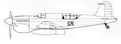

  • Italian AF
  • 1938, in service in 1941
  • Check
  • Caproni; Isotta-Fraschini Asso L.122 of 1000 HP
  • Check
  • Check
  • A fast 1-engined bomber, max speed of 530 km/h clean, 500 km/h bombed-up (shown with a 1000 kg bomb). Two HMGs in the wing. Italians can afford it.
  • A spin-off from the Ca.335 design. wing area of 265 sq ft.

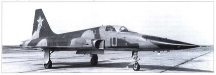

  • USSR, VVS
  • Start in 1964, service entry 1968
  • Check
  • Northrop/Yakovlev; Mikulin copy of the Bristol/RR Viper
  • Check
  • Check
  • A fail-safe bet against the problems with the new generation of fighters, and as a replacement for the MiG-15s and -17s in the world; guns being the left-over 1-barreled 23mm types
  • Soviet moles get the blueprints from Northrop, while Yugoslavia makes an easy access to the small and light engine, that Soviets improve by adding an afterburner

  • USSR, VVS
  • Check
  • Check
  • Check
