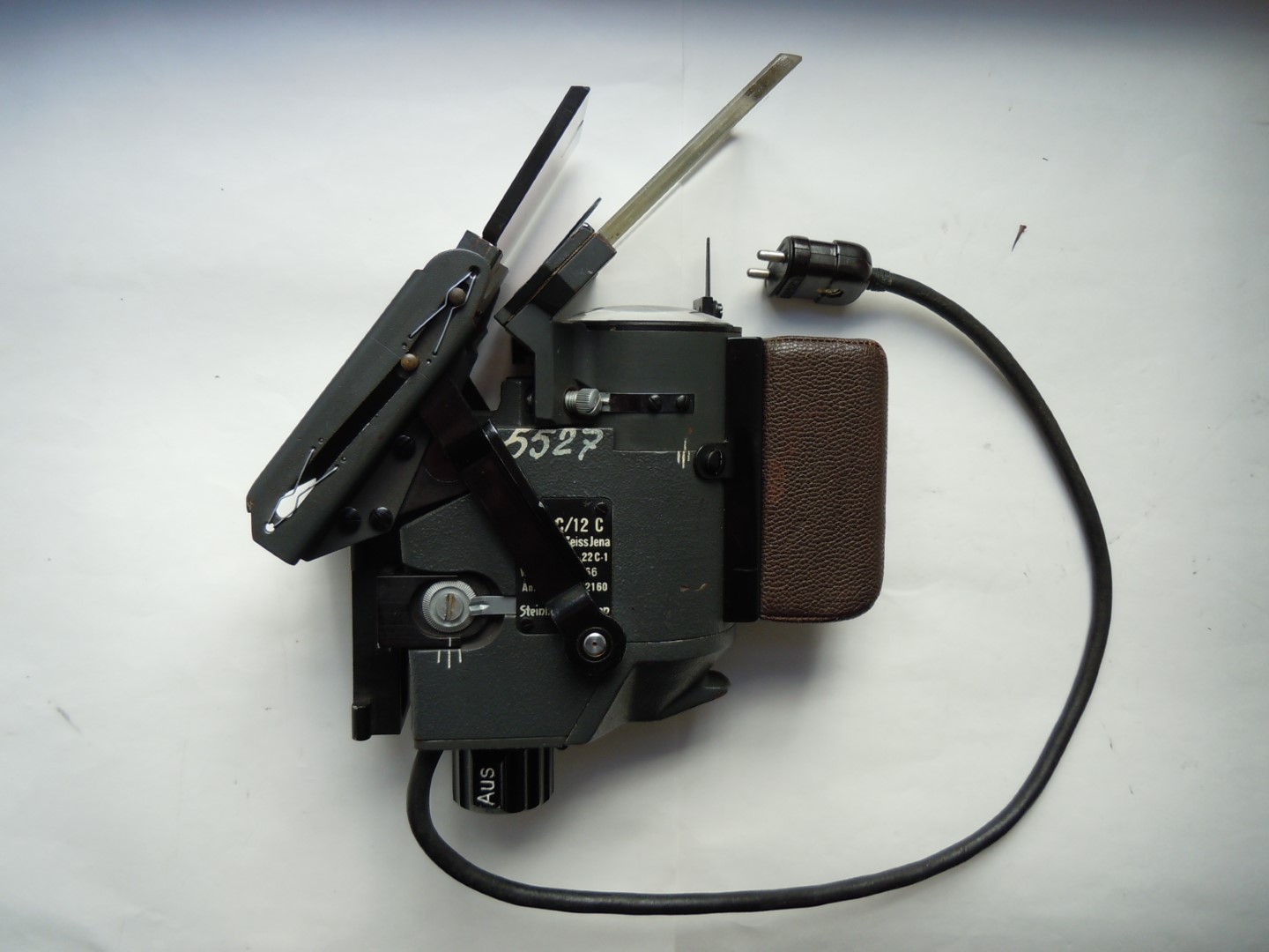

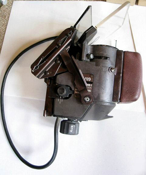

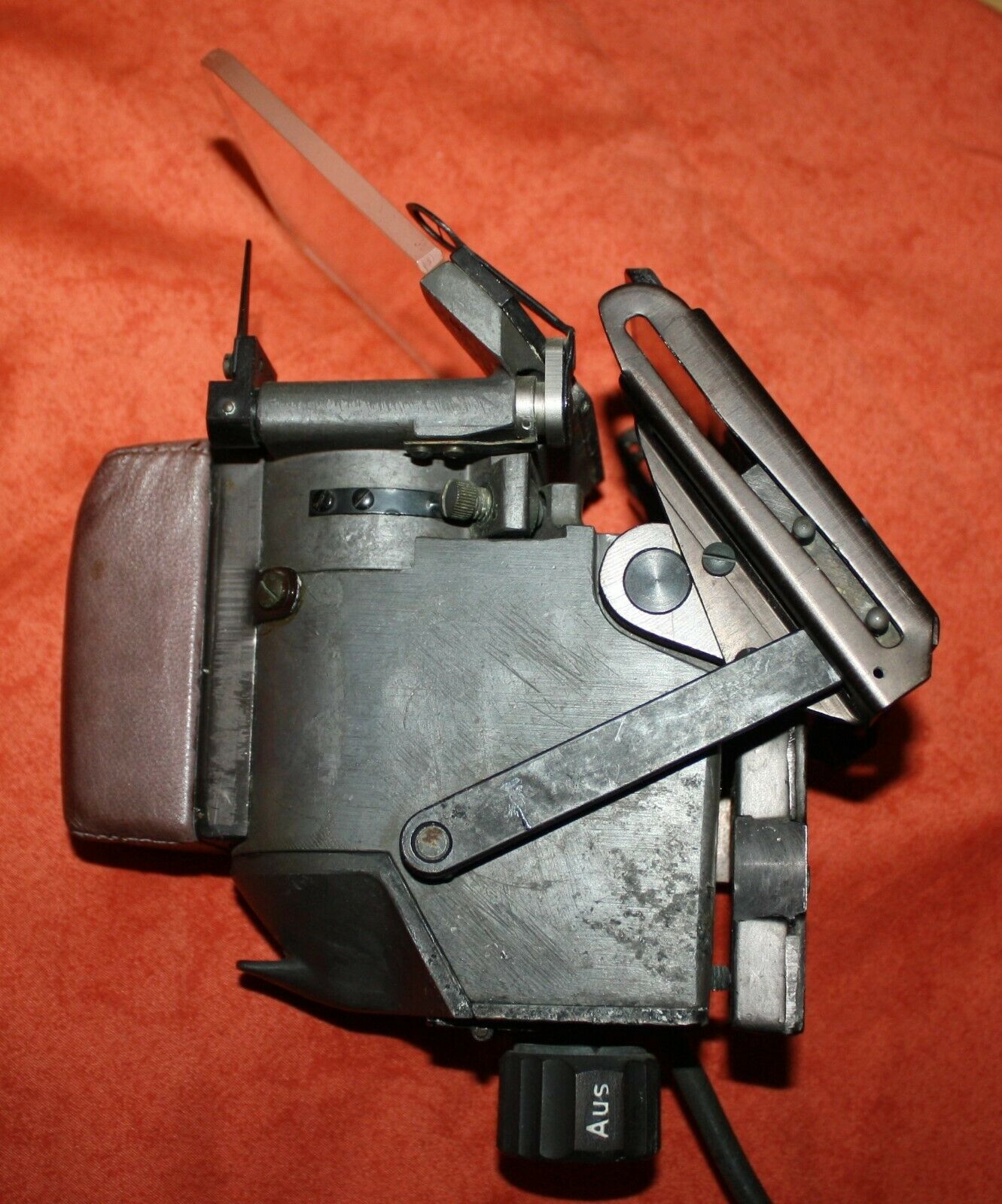

Now I need a bit of help/advice. The kit has no gun sight and I'm thinking this must be an oversight but I could be wrong an if the 87R-2 is without, it would be unusual. I'm also having trouble finding a Stuka gun sight. I realize that the pilot would use the floor window to sight his ground target before flipping over and down into the dive but they also did have wing guns. So any thought/pics/help please gents.
