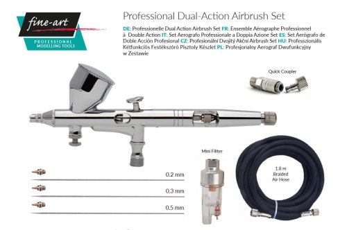

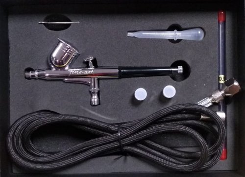

It seesm to be the another one of the quite cheap tools you may grab from the net. I have a similar one but of one nozzle and needle only and it works fine. The Neoeco one looks quite nice , theree nozzles of different diameters, three feeding cups, the fine apperance. It may be worth to buy.
That's what I was thinking, maybe it's worth it...

If you want you may give a try to these ....
