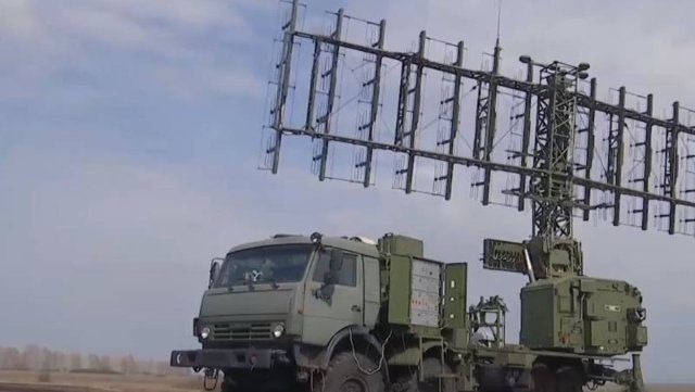

The R-330Zh Zhitel jammer (shown below) has counter-GPS capabilities and is in use by Russian forces in Ukraine

Problem is those munitions will home onto the antenna which may be physically separated from the actual jamming transmitter. Replacing an antenna is easy - just unplug the cable, drive to a new location, set up a new antenna etc.
The other problem is some jamming effects against satellites can be conducted from very, VERY deep in enemy territory. For example, the footprint of a SATCOM system can cover an entire continent which means that a jammer anywhere on that continent can "see" the target SATCOM bird and deliver jamming effects.

Why do they need a strong jamming signal? The signal coming out of the satellites is only about 50 watts. Given attenuation from the atmosphere and other propagation losses, the received signal on the earth is about -125dBm. Doesn't take a lot of power to overwhelm a receiver that's sensitive enough to operate on such a lower-powered signal.
