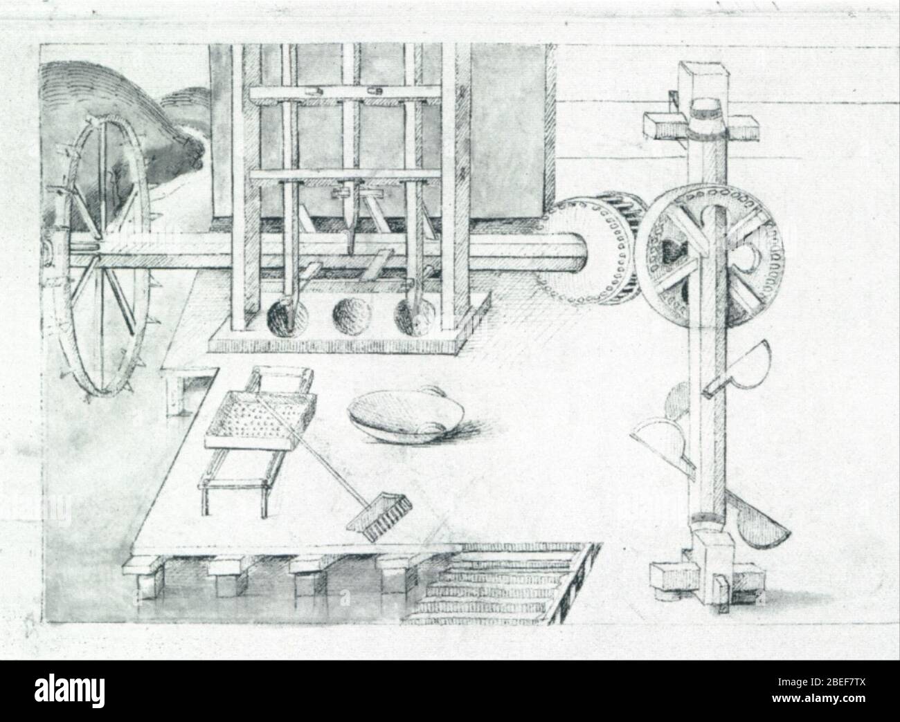

This kind of dips into an area where I have some expertise, perhaps people might find some of this interesting.
The crank shaft, cam shaft, and cam slider date back to Archimedes at least, but only on the scale of simple toys. They were significantly improved during the late medieval period in northern Italy and Southern Germany as a means of converting water wheel power (and to a lesser extent, wind mill power) to create a variety of industrial machinery, semi-automated sawmills, wire pulling mills, paper mills, fulling mills, (so called Catalan) forges and automated trip hammers. In the then Free Cities of Augsburg, Strasbourg Nuremberg and Prague, the first metal examples of cam shafts, sliders, and crank cases were created for the use in clocks and clockwork machines (automata) in the early 15th Century. These water powered, wind powered and spring / weight powered machines were still in wide use through the 19th Century.
The tempering processes they revived for these purposes also date back to the 15th-Century in what was then the Free City of Augsburg, an ancient armor production center where the famous Helmschmied family first made their name, and where Messerschmitt (which name means, knife maker or sword maker) was incorporated in 1926, and one of the places where the Bf 109 was built in WW2. In the 14th century, armorers in Milan figured out how to make a 'harness' (suit) of good quality (largely slag free) medium carbon (about .6%) steel, and then in 15th Century armorers in Augsburg worked out how to properly heat treat large pieces of armor like breast plates and helmets. This made the metal more springy, and effectively doubled the 'toughness' of a piece of steel. Very tricky to properly treat something as large as say, a breast plate, but the craft guilds in Augsburg figured it out. The result of this was that armor could be made half as thick, so a 3mm armor 'proofed' plate was as strong as a 7mm iron plate. Making it much lighter (35 lbs vs 80 lbs for an entire head to toe harness or 'suit') and therefore easier to wear - important at the time due to the rapid proliferation of firearms and super powerful crossbows. The efficacy of this type of armor was far superior to armor that came centuries later such as during the 30 Years War (17th Century), by which time the technology had been mostly lost.
As the political power shifted dramatically in Europe in the 16th Century, many of the armorers from Augsburg were hired by the Holy Roman Emperor to work in his workshops in Austria, and then were in turn hired away by Henry VIII to set up his new arms manufacturing center at Greenwich, England. In 2017 NOVA sponsored a very carefully done experiment where a harness of Greenwich armor from that shop was meticulously copied, using the old processes, and it proved capable of deflecting a 3000 joule musket ball at 20 feet. During WW2 these same armor hardening and tempering techniques were used for aircraft and tank armor, for the same reasons (greater strength for far less weight).
Tempering processes pioneered in Augsburg in the early 15th century were applied to springs, gun barrels, and a wide variety of other devices and machines in the next 120 years or so, and became the basis of the first pocket watch (in 1510 in Nuremberg) and the wheel-lock mechanism for firearms (probably also in Nuremberg around the same time). Rifled firearm barrels, made of the same kind of tempered steel, were 'officially' invented in Augsburg in 1498, though Augsburg town council records mention 'screwed' gunbarrels being confiscated from traditional shooting contests as early as 1420, (because they were considered cheating - but they kept the confiscated guns in the town armory!) Another record indicates a cutler named Gaspard Kollner in Nuremberg (his name indicates he was originally from Cologne) and an armorer named August Kotter in Augsburg who both claimed to invent the first spiral rifling around the same time, in 1520.
