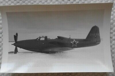

P-63C-5-BE 43-11490 soviet

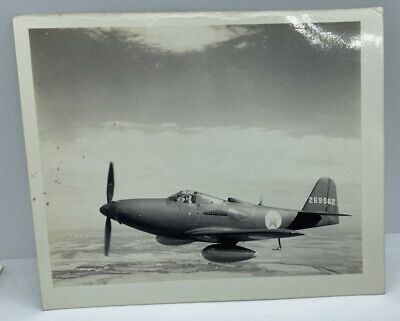

Bell P-63A-9-BE 42-69562

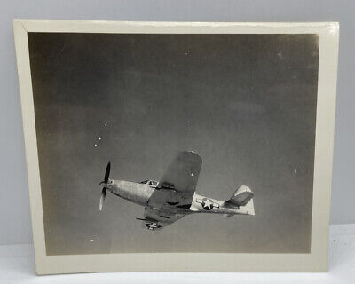

Bell P-63A-6-BE 42-68931 Wright Field Oct 1945.
