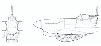

There is more than enough of space to put the external tank under the fuselage, as it was the case historically. Slipper tanks used were droppable, with choice up to 170 imp gals. The Spitfire IX modified in the US have had drop tanks roughly under the cannon installation, so no problems there, too (Spitfire carried bombs sometimes there, plus under fuselage).
Spitfire Vs were ferried towards Mediterranean with 170 imp gal slipper tank and 29 imp gal tank behind the pilot. Different slipper tanks outlines, as well as the 29 gal tank:
Problem was insufficient internal fuel, with additional/bigger tanks installed in a CoG-neutral location as much as it is possible. That problem was being addressed with Mk.III (99 imp gals between the pilot and engine) and Mk.VII/VIII (95-96 gals in main tanks, 25 gals in leading edge tank). Installing the fuel behind the pilot was a thing too, even if it required a better part of that fuel to be used up before combat since the tanks were rather far from the CoG. However, that was too late, it happened after the Allies were already in France.
