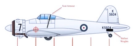

The challenge is how do we install a longer and heavier Twin Wasp into this airframe, shown below with a Bristol Mercury.
Perhaps we can move the wing spar and cockpit backwards. Or stick a lump of weight in that fat tail. I like the incline from the windscreen to the nose for visibility, which should be keepable with the P&W diameter. It would be handy to see a cutaway of the Gloster, as perhaps there's empty space behind the engine like on the Skua.

So how do we make a plane work with a 1438 lb. engine (specifically R-1830-S3C4G) replacing one that was 1065 lbs.(Mercury IX)?
You could start by pushing the firewall back. Possibly behind the leading edge of the wing (if that's possible).
If you can push the firewall back a foot (will probably preclude moving the cockpit back a bit, too), that will allow you to install the longer engine, while the overall length of the airplane remains the same.
This gives the heavier engine less of a "lever" for which to move the CG of the aircraft.
Pushing the cockpit back will help counterbalance that extra 373 lbs., too.
Simply adding armour behind the pilot - similar in layout and weight (125 lbs?) to that in the Hurricane and Spitfire - will make up for 80 lbs(?) of the increased weight of a heavier engine installation. As already mentioned up-thread, the addition of ballast in the tail would have a significant effect also, just at a rough look it seems like it would be at about a 4:1 ratio - so that is another 200 lbs for 50 lbs?. Move the avionics & O2 installations farther back if practical.

I am, FWIW. Anyway, start below.
