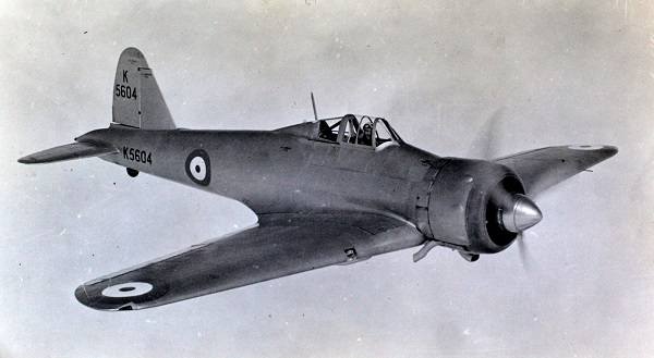

Here's another aircraft which some folks have tried to claim influenced the design of the Zero. And far more close to the appearance of the Zero, too. But - news flash - mid to late 30's low winged monoplane fighter designs with radial engines were hardly unique to uncle Sam, were they?
We could start listing all of the contemporary Italian and French low wing radial engined fighter aircraft with retractable undercarriage and claiming they 'helped' design the Zero too, peut-être? Without that western influence, CLEARLY they would have been made out of bamboo and rice-paper :rolleyes:
