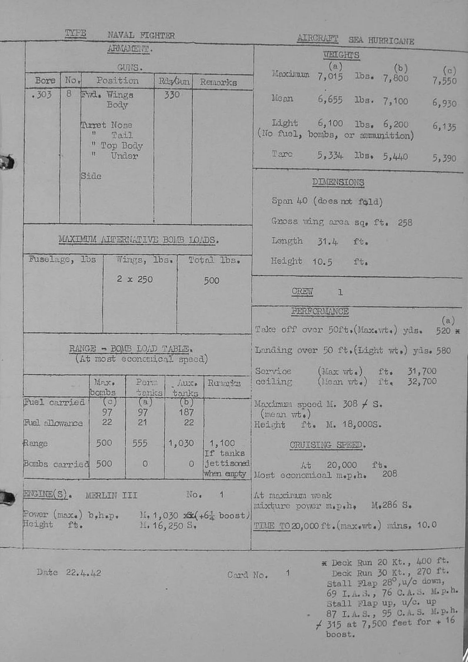

The FAA data cards for the SH1B and Martlet IV don't support the idea that the SH had an endurance of 1hr. How can you look at the data cards and continue to make that assertion:
http://www.wwiiaircraftperformance.org/f4f/wildcat-IV-ads.jpg
The data cards show that the F4F-4B used 25IG (fuel allowance) for warmup, TO and climb to cruise altitude (15K ft) and then had a loiter endurance of 3.4 hrs on 95IG , which was almost exactly the experience of the 10 F4F-4s during the 'flight to nowhere' at Midway. The SH1B had a fuel allowance of 21IG for warmup, climb to 20K ft and then an endurance of 2.7 hours at 208mph (most economical cruise) on 76IG of fuel at 20K ft vs 695miles for the Martlet IV at 213mph (3.26 hrs) at 15K ft . If the F4F-4 had to climb to 20K ft it's range advantage would be diminished further.
However, the endurance for the Martlet IV/F4F-4B was at loiter speed and 120IG less a 25IG fuel allowance = 95IG / 3.4 hrs = 28IG/hr at 15K ft. If we use the HS1B's loiter fuel consumption of 23IG/hr we get a loiter time of 3.3 hrs; 97IG less 21IG fuel allowance = 76IG / 23IG = 3.3 hrs.
Read the data cards carefully as there's a lot of info there that can be analysed to make an accurate comparison.

The F4F-3 could carry 147 US gallons of fuel and here is where I am running into a problem. The capacity of fuel seems to change between US specifications and British specifications.
British data sheets often say 136imp gallons of fuel which would be over 160 US gallons according to standard conversions. and more than an F4F-3 held without protected tanks?
Somebody kept copying the early data when filling out the new data sheets?

A Land Hurricane MK IIA was supposed to fly 500 miles, no reserves, no combat allowance but at 20,000ft and using 29 gallons to start, take-off and climb to 20,000ft.
At most economical that would take over 2 hours.
Now somehow the Wildcat II (that is what the data card says) with it it's range of 795 miles (on 133 Imp gallons of internal fuel?) has a loiter time of 3.95 hours !!!!!!!
Please note that the Wildcat II is supposed to have used up 25 gallons taking off and getting to 15,000ft. With combat allowance it is supposed to have an endurance of 2.6 hours.
BTW the Land Hurricane IIA (best case) is faster, climbs much better and has a take off run to 50 ft almost 2/3s that of the Wildcat. Obviously the carrier equipment would cut into that.

Not if you compare the same things. You don't get twice the range/loiter time on only 30-40% more fuel.
Maybe if the Sea Hurricane wasn't dragging and anchor behind it.
