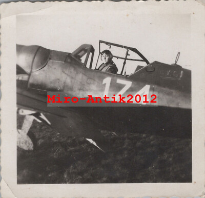

Nr174 Heinz . Meaning of text?
Hi, I believe that this is a Bf 109 G6/14 in use at a training school, with the very high 174 number, and removed Galland Panzer canopy armour.
The abbreviation EVG was the "Elektrisches verstellgerät", which translates as electrical adjustment equipment, or electric actuator. This was specifically the VDM propeller pitch control motor that changed the propeller pitch and it was important for the use of the VDM variable pitch propeller. There are two methods of controlling this propeller, Hand or Automatik, but both use the same electric motor. So, the warning note "E.V.G!" must have been related to a problem with the function of propeller control. The Bf 109 G Handbuch does have a note about how to operate the aircraft if the Automatik EVG control is not working. So, I guess that this was the problem and trainee pilots needed reminding as they got in!

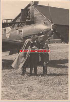

Yes, nice shot #2718. I think a Bf 109 F-2, notice the cooling flaps closed with the flaps possibly fully down. Also, I think, an all-yellow engine cowling.
