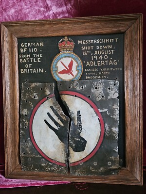

Some poor bloody fool is going to buy this fake!
The hand emblem on Bf 110s of I./ZG 2 was red, not black. Also, it was painted on the MG cowling, which did not have rivets all over the place on it - look at the rivet holes on this piece of crap!

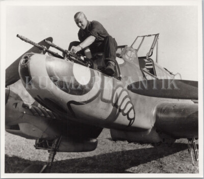

Here's a view of the emblem on the nose of Bf 110 C-2, 3M+CH, W. Nr. 3076 of 1./ZG 2. You can see in a couple of seconds that the e-bay item is a fake.
Agree it's fake. The word "crased" instead of "crashed" is another giveaway that this was manufactured.
