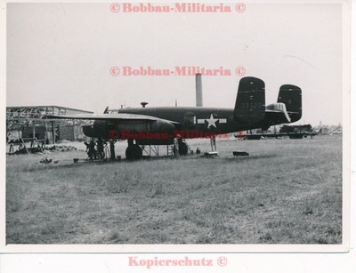

A photo from Fold3 I have since years gave me some food for thought:
These are airplanes on the airfield near Bari in October 1944. Most of them are transports (even a Soviet one) and I believe the B-25 in the foreground is a transport too, not a "Fat Cat", but a high ranking officer's transport maybe. Or maybe not.
It is a B-25C-15, s/n 42-32481 (could be 42-32491 though). The size of the waist windows tells us that this is a Sidi-Ahmed modification (see my post above). It's interesting how the field modified gunner's tail has been re-modified again, after adding the original tail cone to it. The waist windows appear to be covered as well. This could be an a/c from the 310-the BG. or the horizontal lines on both tails have a different meaning.

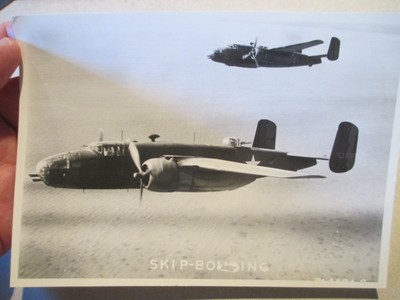

13th Air Force B-25 Low Level Skip Bombing Practice - New Caledonia 1943
Note that the "Mitchell"s above are early modified strafers with 4 guns in the nose.
And here is a photo showing the same 42-nd BG. skip-bombing training from a different perspective:
