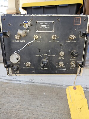

CP-6/APQ-13 RADAR H2X MICKEY BOMBER B-29 WESTERN ELECTRIC
Does anyone know how much total weight the radio gear tallied on these, or any large, late war bomber?

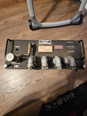

RT-7/APN-1 FREQUENCY MODULATED ALTIMETER RECEIVER

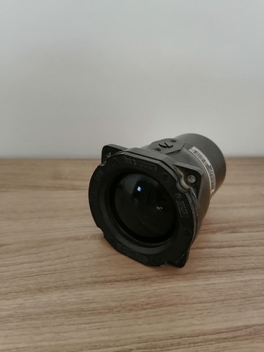

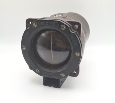

F24 Camera Film Magazine Cartridge 14A/730
WWII Aerial Aircraft F24 Camera Film Magazine Cartridge 14A/730, marked with a king's head, as shown in the photos. The F-24 (14A730) Camera was introduced by the British in 1925 and was used for aerial reconnaissance by British and Allied Armed Forces during WWII and up to the mid-1950s.
Information found: During WWII, the F-24 was installed in various aircraft types, including the Avenger, Blenheim, Catalina, Corsair, Halifax, Hellcat, Hudson, Hurricane, Lancaster, Liberator, Lysander, Maryland, Mitchell, Mosquito, Mustang, Spitfire, Stinson, Sterling, Sunderland, and Wellington.
