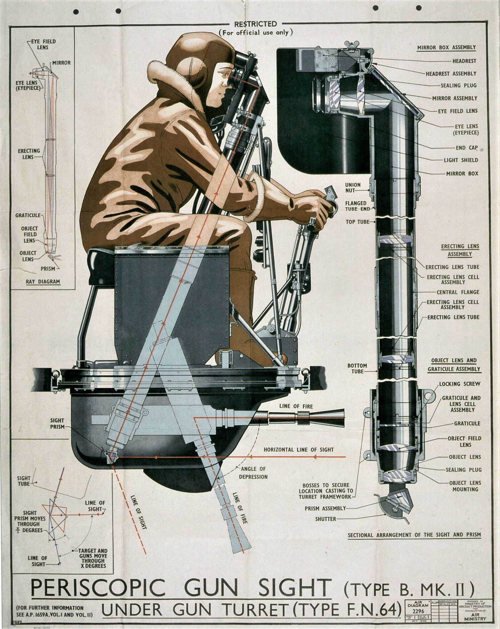

Yes, the 'mid-under gunner' position as it was known, the 8th crewman. A number of squadrons in 4 and 6 Groups added this position in 1944. Quoting from The Crucible of War:
Four Canadian crews who returned safely had been attacked by fighters. In three cases Monica provided little or no warning of the fighter's approach, illustrating is limitations, and only the vigilance of rear and mid-upper gunners enable their pilots to take evasive manoeuvres in time. In the other, Monica did provide ample warning, but it was the mid-under gunner who first saw the fighter 'silhouetted against cloud, below, passing from Starboard to Port.'
This 'mid-under' position was a recent modification adopted by No 419 and other non-H2S squadrons to address the threat of fighters approaching from below.
My dad, a WAG on the Halifax bomber, told me the Germans quickly learned the vulnerability of the Halifaxes. They would come up from underneath, where the Hali was vulnerable. Which worked well until many of them pulled the radar out of the dome, cut a slot in it and put a man with a 50 cal waiting there for them. He never explained who was the lucky guy who sat there. Surprised many a fighter at first…
Hallies and Lancs did have lower gun positions. They were removed because they were pretty useless, tho helped with morale.
After the Luftwaffe became aware of Monica from a crashed bomber, German scientists developed a passive radar receiver, named Flensburg (FuG 227). From early 1944, FuG 227 was used by nightfighter crews to home in on Allied bombers using Monica.
There was also the Preston Green mid-under turret, which had a single .50-cal machine gun. This was fitted to some Halifax bombers, but as H2S became more widely available, these turrets were replaced with the H2S radar dome.
There were also jury-rigged mid-under gun positions in some squadrons.
The turrets worked well enough -- in daylight (see RAF Mitchell squadrons).
Maintaining a search though a periscope, for hours on end, at night, was deemed difficult enough to not warrant inclusion.
The more ad-hoc .5-inch position Rjay's father describes is something different.
