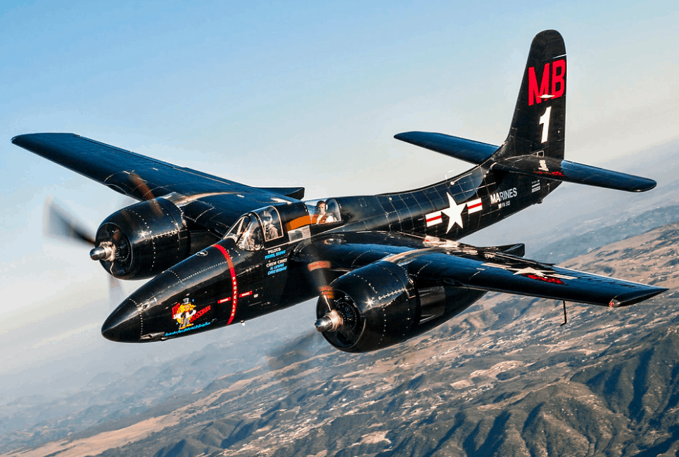

F7F-3 BuNo 80458

The F7F-3 was a radarless fighter bomber for daylight operations, and therefore radarless.

The F7F-1 and -3 were single seat, day fighter models that had 4x0.5" in a nose that lacked radar.
The F7F-2 was a two seater intended as a night fighter with AN/APS-6 radar in the nose. Most were built as F7F-2N night fighters, BUT some were built as F7F-2 but still retained the second seat looking at the photos. The -2N had the radar but no nose armament. The -2 had the nose armament and no radar. But the -2 also had provision for an 80 gallon reserve tank in the rear cockpit space, a feature shared with the following F7F-3 day fighter.

It can't be a two seat F7F-3N as it had a different radar and nose shape.
So, at the moment, I can find nothing to suggest that the F7F-3 got the AN/APS-6 radar. I think the diagram is a composite of features that appear on the F7F-2 and F7F-2N.

And yes both models had the AN/APS-6 radar. The F7F-3N got the SCR-720 radar which needed a larger radome.
