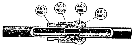

The Brits used several different fitting combinations in fluid (hydraulic/fuel/air pressure/vacuum/etc) systems. As I was told at the beginning of my training - there are three ways to build an aircraft - the right way, the wrong way, and the British way.
Starting with flared systems - they only had one flare angle - I don't know what the angle is because you only need the one tool kit for British flares instead of two for US aircraft - or one after about 1940. That said the Brits make up for it in multiple ways of using the flare and creating assemblies that make you hate working on British aircraft.
This is a typical flare fitting and a cutaway diagram of how it assembles. My apologies for the sh*t photos that follow.

Well now - from that the Brit angle is 32 + 1/2 degrees - that's good I learned something today.
