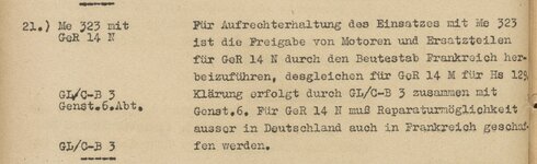

Seems like that Germans didn't know what to actually do with the G&R 14N engines. The report from 19th March 1943 says:
Roughly: out of 1400 of the 14N engines 'found' in France, 1000 are the complete engines, and 400 is the equivalent in the spare parts. Further engines 'found' will be delivered to the GL/E. Repair capacity is in both Germany (in Hameln) and in France.
Report that predates that, dated at 12th February, notes the intention to outfit the Me 323 with the 14N engines, and asks about the repair facility in Germany to cover these engines:
