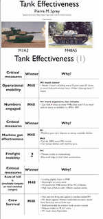

Click on the attached image.
Thank you.
Once we correct to M1A2 vs M48A5 things are both a bit better and a lot worse.
Both are MBTs but now we are comparing a new tank (or a newer referb) to a very old tank with an old referb job.
M1A2 dating from the 1992 and later compared to around 1975 for the M48A5. did they adjust for inflation?
Reliability is rather suspect. Granted they used a lot of new stuff in the mid 70s but they were rebuilding a tank made in the 1950s. How reliable the 1975 tanks were in 1992-5 is certainly subject to question.
Basically, they only listed questions where the M48A5 would come out ahead and didn't ask any questions where it would come out behind. M48A5 was away to get M60A3 performance on cheap. That is up-grade the old M48s up to close to the M-60 performance levels.
One thing (out of many) is that the M48A5 did not use a gun stabilization system. Very hard to fire on the move. Some M-60s got stabilization added on in retro fits. M1 Abram had it from the start. Not all systems preform the same.
The comparison seems to be not valid. M48A5s may have been out of service (retired) before the M1A2 was put in service?
Thank you.
I was able to pull up the full slideshow. It is from 2007 and in that context it is incredibly silly.
Thank you very much.
From that presentation ( 😵‍💫 ) I can conclude that either they were using GIGO (garbage in garbage out) or were out right lying to make their point.
It was silly at any point in time. It started off bad and did not get better. His/their ability to mix/ignore timelines was amazing as was the ignoring of different capabilities.
It was much like the stuff put out by AI without AI.
maybe he/they have better stuff out there but that was enough to deter me from wasting any more time on it.
