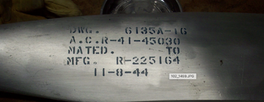

Can anyone help be determine the correct way to mark a 1944 Hamilton Standard 2B20 propeller blade? Specifically looking for what DWG referred to. Is it the Blade drawing or drawing for something s else. Is the part number on the Hamilton Standard picture, the part number for the blade, hub, or something else? Cannot find and Drawings for the 2B20. First Picture is for a McCauley prop. Additionally what does "A.C.R." refer to in the third photo?

Welcome to the site.
As memo serves, the DWG number should be stamped somewhere at the prop blade root. Have you checked on that? Also the number "2B20" is a hub prop model and is a part of the prop number only. The prop balde types that could fit the hub are the different matter IIRC.

Here is the required blade markings per EO 15-30A-3 from about 1952.
There are three different blade drawing numbers/models possible for the 2B20 propeller are "6109A-?", "6135A-?", and "6241A-?". The"?" is the blade cutoff, the cutoff depends on the aircraft that the blade is installed on.
Very helpful. Thank you very much.
