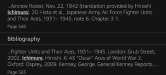

So where is the evidence that Claringbould or Dunn's claims are derived from Umemotos work? Because your whole reply looks like you are attributing the narrative in a Japanese account as being analogous of the argument made by Claringbould or Dunn.
There is no mention of any Umemoto book in the bibliography of the one Claringbould book that I have.
Umemoto frequently switching name between Hiroshi Ichimura and Hiroshi Umemoto, if you search Ichimura you will find both Dunn and Claringbould used his work as some sort of source, he was also a listed by Claringbould as one of the historical associates.
He does not appear in the bibliography of Claringbould's Ki-43 vs P-47 book and he only appears in a single footnote of Dunn's book South Pacific Air War. One of Ichimuras book also appears in Dunn's bibliography amongst hundreds of others sources.
I don't see a compelling link here to this idea that Claringbould or Dunn's work is heavily influenced by Ichimura / Umemoto to the extent that you could reduce it to both authors parroting a narrative as you seem to have done.
