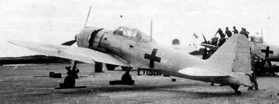

The Forum has already established, in multiple threads, that applying Balkankreuz to any aircraft will immediately improve performance.
Their performance and everything else about them were so superior, it's almost as if they couldn't lose. It makes you wonder. Did they lose? Or are we all just sheeple? :flushed:

If the USAAC/AAF was favoring a lightweight fighter, the closest to a viable one seems to be, IMO, the NAA P-509. Wing area of 180 sq ft (IOW, similar to what the Soviet fighters of the ww2 mostly had), and 5 feet shorter than the future XP-51. Design is covered in the Bill's book, and some snippet about it & illustration can be read here.
The results of a Blackburn Botha getting transsonic at Boscombe Down has only been partially suppressed.
BTW Key in balkenkreuz in The Forum's search and see what comes up.
No, it is not and if you cannot see the difference then you are correct. Further discussion is pointless.
I don't think you were even trying to have a discussion. And yes, i agree, it's pointless to try in this, y'all managed to snuff out another one on this forum. Ever wonder why activity here is kind of diminishing? ;)
This is just the sour denouement of what could and should have very easily been a light, pleasant, and dare I say, enlightening discussion? But this seems to be a pattern on this forum, for all it's virtues.
The vast majority of this forum's membership are knowledgeable folks who will engage in a scholarly discussion - however, there seems to be a few, who for some reason, live to argue and will fight to the death over a lost point.
It is what it is, I suppose.
