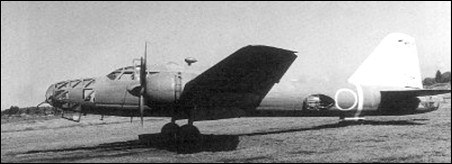

The G4M design was specified with the ability to carry 1x air dropped torpedo or 2000 kg of bombs. As such, there was no adapting needed. In effect it was specified as a torpedo-bomber, in a similar manner to the B5N Kate. (I suppose you could claim it was a bomber-torpedoer, but torpedo-bomber sounds better. :))
It was a medium, land-based bomber that COULD carry a torpedo when required. When not required, it was rigged for regular HE bombs. When torpedos were required, the racks for torpedos had to be mounted, the same as for ANY bomber that was "rigged" for torpedo duty that was not a regular torpedo bomber. Designing in the torpedo adapters simply meant that there was no jury-rigging required.
It was not normally a torpedo bomber, but could be pressed into service as such easily.
They rigged a Fiat G.55 S Centauro to be a torpedo bomber, too. See below:
But not many G.55s were so fitted and, when not needed, even the G.55 S had the torpedo mounts removed.
The Bettys were the same. They used them with torpedo hardware when required and remove same when it wasn't needed.

G4M1s (probably model 12) flew a series of high altitude bombing missions over Australia (Darwin), Max bombing altitude was ~29k ft against the USAAF base at Fenton.
The G4M wasa twin-engine, land-based, medium bomber that was adapted for torpedos when so required. It was not designed primarily as a torpedo bomber, but was adapted as one. It was decently high-speed for when it first flew, but "high-speed" in 1939 was not the same thing as "high-speed" in 1944, as we all know.
At Guadalcanal, the Japanese lost 100 G4Ms with crew and there were no replacements available.
I got news for you, the US lost a whole lot of P-39s, F2As, F4Fs, SBDs, TBDs, TBFs, B-26s, P-40s, Hudsons, etc. etc. in the first year of the Pacific War. Attrition rates were high all around, including and especially at Guadalcanal.
The G4M was not a bad aircraft, but its design was also not very adaptable as far keeping it current with fighter aircraft was concerned. It started out with 1,530 hp Mitsubishi Kasei Model 11 engines and went to Kasei 21s, Kasei 25s, and Kasei 27s, eventually with 1,820 Kasei 27bs engines. The horsepower increase did not quite keep up with weight increases. The late-war Betty was sort of like a late-war Wellington ... OK but not exactly top-tier equipment by that time.
Much the same could be said for many medium bombers. Some "kept-up," many did not.
A late-war A-26 Invader was a completely different animal from a G6M Betty. The A-26 could hit near 360 mph and that made it tough to catch for most fighters, especially down low. The Betty was maxed out at 265 mph and couldn't escape from even P-40. But, if it got through, the Betty could hit you about like an A-20, with about 2,000 pounds of bombs. It was very A-20-like in performance, but slower by about 50 mph.
But the G4M was a very early-war design. Why would you compare a 1941 bomber to a 1944 bomber. If you want to compare it to a Ki-67

The first 30 "production" planes were built as heavy escorts for the G3Ms but weren't fast enough to keep up with them once they had dropped their bombs.
First bombing raids were in the late spring or early summer of 1941 over China and hundreds of miles from blue water.
Once they ran into even average Western fighters losses mounted. With no passive protection, 4900 liters of fuel and four Lewis guns and a single slow firing, hand aimed 20mm cannon with 15 round magazines, and a cruising speed of around 200mph the idea they could operate without fighter support was crazy, And the A6M never had the range to escort the G4M to the extent of it's range (although the book ranges maybe incorrect, like max range was without bombs as the G4M1 had a gross weight of about 21,000lbs and 4900 liters of fuel is over 7700lbs of fuel) in plane that was supposed to weigh just under 15,000lb empty.
It was a Navy bomber. Land based but made specifically for the Navy. It wasn't made to fly deep into the US, Australia, or Russia and hit strategic targets.
What it actually did most effectively in the war was mostly sink ships. In that role it was fairly deadly.

I would say that the G4M was a torpedo bomber which could also work as a light bomber of airfields and ports.
For some reason that I have no explanation for the Japanese never or almost never, built a 2 engine bomber that carried more than 1000kg (2205lbs) of bombs,
