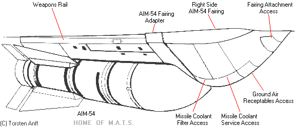

How bad a suggestion is to have Fw 190 'bomber' outfitted with 'cone' under the fuselage to streamline the bomb installation?
roughly illustrating the idea)
