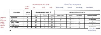

A table taken from the Russian book about ww2 tanks:
A few details stand up. Like how he tiny the Valentine was, and especially it's turret. Or, that Cromwell didn't get even the 77mm HV, while the Sherman received the 17pdr despite the small turret. Or, that Panther's turret was just 2/3rds of the volume of the Tiger's turret.
The figures for the turret volume should be just for the 'real' part of the turret, ie. for what is above the hull roof.
The prop shaft that went under the turret basket and the transmission were still eating a lot of volume, even when the 'lowering gearbox' was used.
TypeArmored Volumein M3VolumeofComponents
Combat WeightHullTurretTotalDriverFighting AreaEngine BayTransmission
Valentine175.81.16.91.22.62.11
Mk III2291.510.52.24.83.5spread
Cromwell289.71.911.624.93.41.3
M4A2 Sherman31111.812.836.92.9spread
T-34/853210.6212.62.25.23.71.5
Panther4514.92.317.257.34.9spread
Tiger I5614.83.418.249.64.6spread
Edit: For others to use in the future
Note that you can see the trade off of sloped armor, more interior space is wasted from the angles, vs the 'bunch of boxes' exemplified by the Tiger and British, that tended to go for thicker vertical plates to protect a smaller volume.
You can see, the Panther was physically larger than it needed to be
