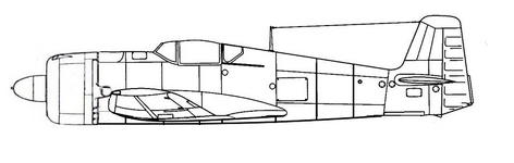

Fighter loosely based on the He 100, with a 2-row radial in the nose. Might've been a good option for Sweden (a few years before the J.22), Italy (eg. Regianne making it instead of the Re.200x series that was made in penny packets). Italians can put the French G&R 14N in the good use, too.
Depicted is with Japanese engine, so this is another option. Note that lower fuselage is deeper now, not unlike what Ki-61 gained when it was becoming Ki-100.
