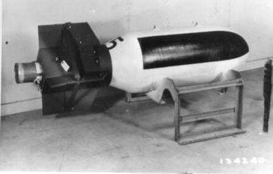

The B-29 did indeed use a glide bomb but it was in Korea. It was the 22000lb VB-13 Tarzan glide bomb. It was used very successfully against bridges by the 19th Bombardment group. It was guided visually by the bomb aimer who locked on to the target by visualising on a tail flare. The guidance system was by RCA (Radio Corporation of America). The VB-13 was a converted Grand Slam bomb.

It is indeed a glide bomb, the VB-13 has a circular wing round the bomb, it is not an azon
The VB-13 did have a circular wing.
Now how much lift they got out of the wing or what the glide ratio was I have no idea.
Perhaps it just helped stabilize the bomb to keep the "rudder" and "elevator" from rotating around slowly?
Maybe it did extend the range of the bomb a small amount or at least helped keep the bomb aimer located over the bomb as it fell so the bomb aimer could steer the bomb?

In OP 1664 US Ordnance May 1947 edition the Tarzon is included in the section on AAF Guided Missiles and is described thus:-
"This missile consists of a modified Bomb T10 with a circular, 54-inch shroud about its body for lift, an octagonal tail surface for control, and the radio control mechanisms for guidance in range and azimuth....."
T10 was the US designation for Tallboy. Note the use of the word "shroud" not "wing" in the description.
It appears in the same section as the Azon and Razon. Also in that section are the 2,500 pound GB-4 Air to Surface missile which is described as a "glide bomb" which had a "special plywood airframe built around a 2,000-pound bomb, with rudders and elevators but no ailerons." It had a 12ft wingspan. Similarly the GB-8 is described as a glide bomb. As is the Bat.
So clearly US officialdom drew a distinction between "glide bombs" and weapons like Azon, Razon and Tarzon.
Page 543 of the manual onwards.
