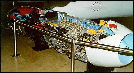

I visited the British Science Museum last week and was surprised by how compact British jet engines were compared to their long German competitors.
I wonder what aircraft the Germans could have designed had they had Britain's compact turbines.
Compact in length, not in diameter.
Derwent I
Length: 84 in (2,134 mm)
Diameter: 43 in (1,092 mm)
Dry weight: 975 lb (442 kg)
Jumo 004B
Length: 3.86 m (152 in)
Diameter: 81 cm (32 in)
Dry weight: 719 kg (1,585 lb)
I don't think that the length of the jets was particularly a problem, but increase in diameter may have been.
No need to speculate, the Heinkel He 178 was based around the HeS 3, and ended up being basically identical to the Gloster E.28/39.
The Germans stopped developing the centrifugal designs as their frontal area created more drag which was working against the entire concept of a high-speed powerplant. The axial design was also obviously easier to develop in a multi-stage fashion as the compressed air exited directly onto the next stage and didn't require the weird piping you can see in the Whittle designs - and von Ohain's as well.
