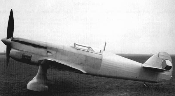

To get 1200-1300hp out of the 12Y you have two choices.
Higher RPM, doesn't look good if they already have to start beefing things up to get the 2500rpm mark (and the only major user was the Swiss). Increasing the rpm increases the friction and the stress on the moving parts by the square of the rpm.
Higher boost pressure. Which also goes back to the strength of the parts. You aren't squaring it but you are going to have to raise the BMEP by around 20-30% to reach your goal.
Hispano engines were not noted for making it to 100 hours on test as it was.
The Russian M-100 went about 470kg, then there was a somewhat steady progression of weight increases through the 495-510 kg of the M-103 to the 570kg of the M-105 to the 600kg of the M-105PF. Granted it gained a two speed supercharger along the way (and 3 valves per cylinder) but it didn't hit 1300hp either (until 1944?) and the 1260hp rating was at 700 meters (yes 700) and was achieved by shortening the engine life. Also note that the M-105PF ran at 2700rpm.
The 12Y-50 was supposed to weigh 492kg.
Please note that the S-P supercharger was supposed to lower the inlet temperature by 60 degrees C which is where a lot of the improvement in the forty series engines that used it came from. The original H-S supercharger wasn't very good. Now perhaps the S-P supercharger was over complicated, but it had already made a major contribution to the power output and expecting a another major jump in efficiency (as opposed to brute force pressure) doesn't seem likely.
There are teething problems and there are problems that are not teething but fundamental limitations.
The 150 X 170 H-S V-12 engine dates from 1928.
The 12Z had teething problems but it used a new crankshaft, new crankcase, new connecting rods (fork and blade) new cylinder heads and new valve gear.
The 12Y was flogging a dead horse.

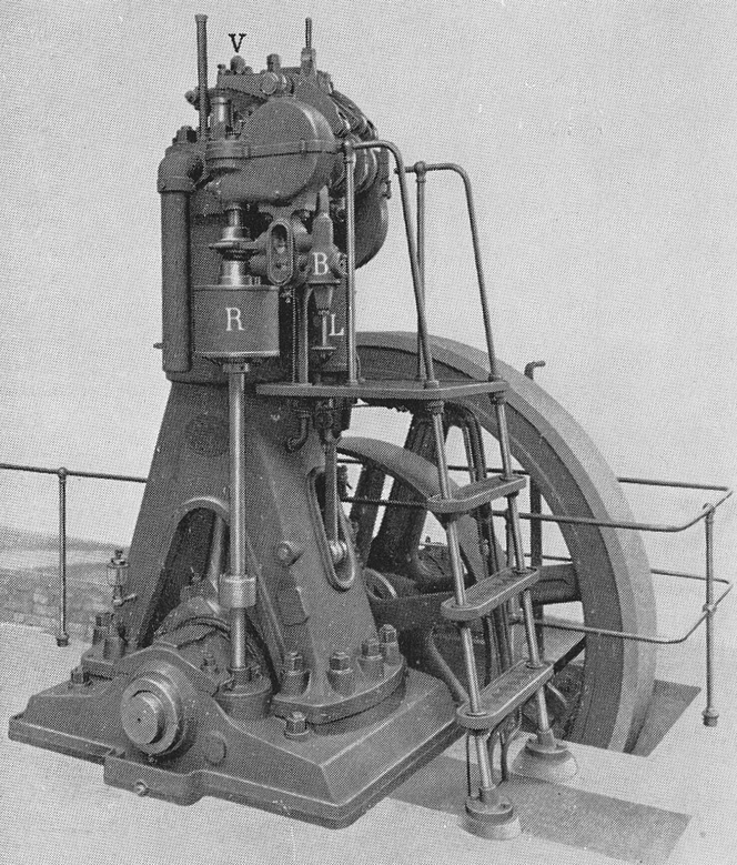

One might also look at the Sulzer company including their Diesel engines.

Sulzer was a pioneer in the development of the diesel locomotive
And a major player in the marine and large stationary engine market, now as a part of Wartsila.
