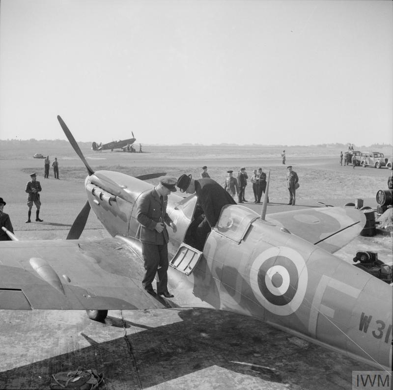

That photo is a 92 Squadron Spitfire VB.
This is a Spitfire II of 19 Squadron at Fowlmere in September 1940. It's new and clean.
Check out the 100 octane fuel bowser!
The Spitfire II pilots thought it was good at altitude, for example Combat Report - F/Lt. J. C. Mungo-Park, 74 Squadron, 30 November 1940 . (Shared with H. M. Stephen. Uffz. Fritz Wägelein, 5./JG 53. BF 109 E-4 Wk Nr 1145. shot down and wounded. )
