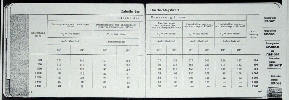

table
Penetration table for the Soviet 85mm gun, for different ammo types: table
