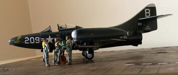

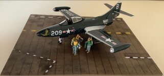

Paint's on! I started with black primer and then a coat of dull aluminum because I was afraid leaving it black would make the dark blue just too dark. It may have also had the benefit that I got no peeling at all from the masking, which I almost always got before with Vallejo.
Now for some touch-up, gloss coat, and decals.
Decals are on, but there's a bit of touchy work still to do. The decals for the red nose flash fit terribly and did not look right at all. I'm going to have paint it. I have frisket paper, which should be pretty good for this sort of thing. The top line of the red runs along a panel line, which will help. So with a sharp blade and a bit of luck I think I can pull it off.
The next delicate step will be the thin off-white border around the canopy. I think I'll just seal what I've got so far with a satin coat and leave the rest to the weekend.
Though come to think of it, some bomb mission markings on the right side might be nice...
