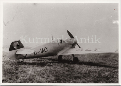

D-IALY Me109V-4 Spain Condor Early

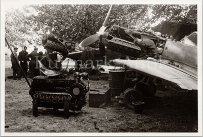

Engine number 61020 and 643?? JG51 perhaps of intrest to E Engineman
These engines, 61020 and 643?? are DB Genshagen built DB 601 A. There is certainly engine change work here, and that was not unusual with the short engine life and engine returns to repair shops for overhaul or for fault rectification.
