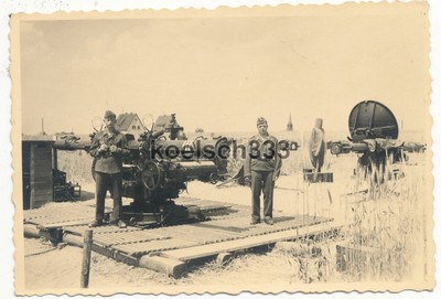

Würzburg D. Large, wooden platform, so a type D2 (Schwermetall-Lafette) or D3 (Kurzer Schwermetall-Lafette) F Factfndr54 correct?
Hello Snauzer01. Nice picture.
Würzburg D2 and D3's have a circular wooden platforms ('Umlaufrost') that is part of their Lafette.
Your picture show a type 'C': a rotating dipole and no peephole in the dish (like type D).
Würzburg C's are mounted on a trailer ('Anhänger A2'), platforms were locally constructed and fitted just between the trailer and the rotating Würzburg.
Often you see the wheelcaps sticking though the platform, see attachment
Würzburg stellung Bothfeld Flak Ers. Abt. 6
Würzburg type "D', note the peephole for the 'Rundblickfernrohr' and presence of an EAG-62. Note the platform: type is D2 or D3 on Lafette.
Also note the tubes to support the seats, this not standard
