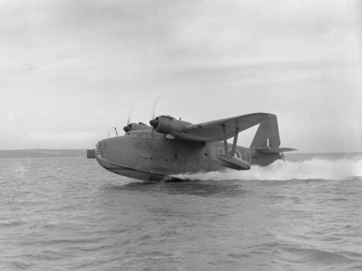

the Lerwick more than a bit a bit of dud. It was an outright menace to it's crews.
"The Lerwick was immediately found to be unstable in the air, on the water and not suited to "hands off" flying. The latter was a major problem in an aircraft designed for long-range patrols."
"failed to remedy its undesirable characteristics, which included a vicious stall and unsatisfactory rates of roll and yaw"
"On one engine the Lerwick could not maintain height, nor could it maintain a constant heading, as the controls could not counter the torque of one engine on maximum power.[9]​ An engine failure would inevitably see the aircraft flying in slowly descending circles"
A twin engine plane that cannot maintain height on one engine and cannot fly a strait course on one engine has no business fly more than few miles off shore.
It is one thing to try and fix a few things, the Lerwick had too many problems. Even with more powerful engines you needed larger vertical fin and rudder to steer a straight course (and maybe better ailerons) and trying to land a large, heavy flying boat that has a viscous stall sounds like a rash of landing accidents waiting to happen.

With flying boats it was similar, the Sunderland was very good though slower than a H8K. The PBY was very reliable and good enough, the Anglo-Amnerican / ANZAC forces also had the very useful Hudson, and later the faster but a little more flawed Ventura; then they had the Navalized B-24 (PB4Y) which proved very helpful as an armed scout with it's excellent range. The Allies also had the superb Beaufighter which I think really proved very useful, the B-17s which were quite good as heavy long range scouts, with endurance similar to a PBY but much tougher if they got caught by fighters. P-38s also made good armed scouts, and the various US naval bomber and fighter types, of which I think the F4U IIRC had the best range for a figther and the TBF /TBM was probably the most useful as a scout-bomber / ASW.
