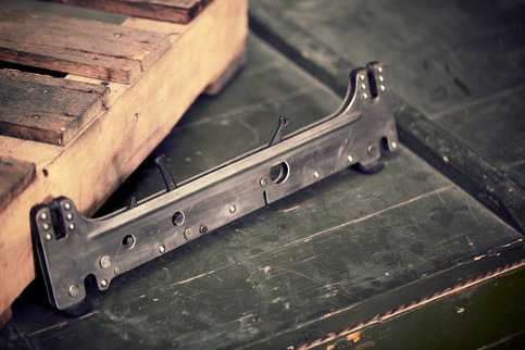

I need a drawing/illustrationof a B-7 rack if someone can help.
Hi Bill here is what I found. Hope it helps. Link to website of origin included.
Darren - thx. I have that but was looking for one actually attached to a P-47... but thx again.
Ah ok...to add to what others have posted here's the B-7 shackle mounted inside the belly of the Thunderbolt with the sway braces and fuel line included. If you look closely you can see the suspension hooks.
Picture is from Britmodeller website but unfortunately has no attribution to the original source.
Outstanding image Darren - thx
