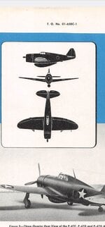

Anyone else ever see any other images or info on this tank in the above image? I cannot find any info on this, despite Greg claiming he has 4 documents on this.
I personally think this tank doesn't exist or never made it through development. Even if it does exist, we have no evidence it was pressurized, or otherwise worked correctly. It hardly looks like it would jettison.
Personally I think this is a error in artistic rendition or something in this manual.
That's a snippet from the manual for the P-47C, D and G.
The belly tank artistic rendition in the 3-view is indeed faulty - the belly tank was sorta slipper tank as used on the Spitfires, if more complicated in making due to the all-curved sides.
Well what I am trying to rule out is the existence of a second tank. I've only ever seen the ferry tank.
I've seen no evidence at all of anything other than the ferry tank and presumably this is just an artistic error. But I want to know if anyone else has ever seen any tank that looks like this banana thing
