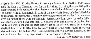

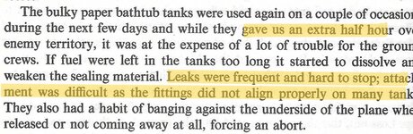

Greg needs to come forward with his other 3 supposed documents on this tank.
Here is what I suspect:
These documents refer to the ferry tank and he has just read into them the existence of this unicorn tank. In the debate he stated that he "thinks" the image I posted above is the 200 gallon. So this implies there are no pictures in his other documents, which suggests to me he has no means of correlation between them because the Jan43 manual with the image he thinks is the unicorn tank contains no named nomenclature. So without either a pair of images or a name for this tank, how has he even confirmed that whatever documents he has are even about the same thing....or are just not about the 200 gallon tank everyone already knows about.
I think that's more likely than Greg discovering from nowhere a mystical drop tank nobody in the historical record has ever before mentioned.
Additionally: if there is some separate 200 gallon tank out there....how did nobody at the time try to use it? P-47s obviously used other drop tanks in 1943 and everyone was scrambling to make improvised tanks as well. Are we meant to believe that all this was going on and somehow everyone missed that there was a perfectly good drop tank made by Republic that could have been ordered into production? Surely Republic would have been screaming about it.
And Greg can't say that it's because the mafia blocked drop tanks because other drop tanks were already in use at the time.
IMO Greg was being disingenuous when he suggested the tanks didn't need to be pressurised above 20000 ft, since he said thousands of commercial aviation airliners were flying around with unpressured tanks at much higher altitude to this day.

Any discussion of pressures, bleeds from instruments, paper tanks, glass fibre tanks, shackles, mountings, approvals and designs, secret projects and ideas is a welcome and well used distraction from the plain and obvious fact that a 1943 P-47 couldnt engage in combat over Schweinfurt for 15 minutes and then make it back to the UK. The other "thang" that must never be discussed is if the "bomber mafia" werent committed to unescorted bombers being self defending what would they be committed to, as a doctrine? The P-38 was like rocking horse manure in 1942, the P47 was just being sent to UK (operational in Spring 1943)and the P-51 was in the process of fitting a Merlin. The P-51 may have turned out to be the best escort fighter of the war, because of what happened, no one in the USA in the mid 1930s could have strategy based on producing it.
