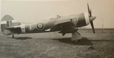

ORIGINAL AIR MINISTRY MW801
That looks like a Tempest II :)

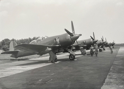

Trainer
I think they're actually target tugs, for use with the (then) West German Luftwaffe, and painted red overall.
Yep .. the foreground one is registered as D-CAMI while the background one D-CATA. Both of them have the small German flag marking on the fins.
Good shots!
